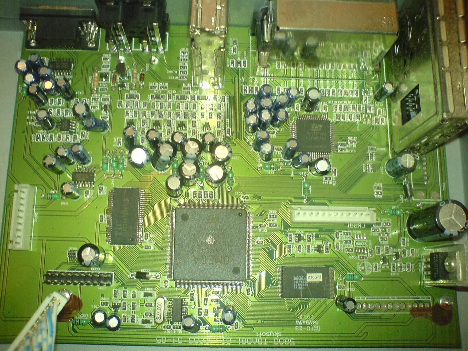

bairam Posted October 22, 2008 Author Share Posted October 22, 2008 Плата AKIRA DSR-133AS Quote Link to comment Share on other sites More sharing options...
